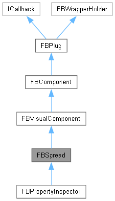

Base spreadsheet class. More...
#include <fbcontrols.h>
Definition at line 1568 of file fbcontrols.h.
