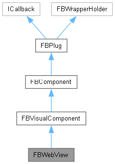

Web viewer. More...
#include <fbcontrols.h>
Public Member Functions | |
| FBWebView () | |
| Constructor. | |
| void | Load (const char *pURL) |
| Load the specified Url. | |

Web viewer.
Definition at line 2217 of file fbcontrols.h.
| FBWebView | ( | ) |
Constructor.
| void Load | ( | const char * | pURL | ) |
| pURL | url to load in the WebView. |
