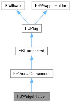

Native Widget Holder (can be used to embed native Qt Widget inside MoBu UI elements) A Widget holder provides a bridge to instantiate a Native Qt widget into MB framework. More...
#include <fbcontrols.h>
Public Types | |
| typedef QWidget *(* | WidgetCreator) (QWidget *pParent) |
| typedef QWidget* (WidgetCreator)(QWidget pParent); | |
Public Member Functions | |
| FBWidgetHolder () | |
| Constructor. | |
| void | SetCreator (WidgetCreator pCreatorFunction) |
| Add a function that creates a native widget (a QWidget on Qt platform) On Qt, this creator function will take a void* (which can be cast as a QWidget) as the Widget parent On Qt, this creator function should return a void* (which will be a QWidget) that will be the newly created widget. | |
| virtual QWidget * | WidgetCreate (QWidget *pParent) |
| virtual function to be override in subclass. | |
