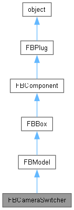

Camera switcher. More...
#include <pyfbsdk_generated.h>
Public Member Functions | |
| FBCameraSwitcher () | |
| Constructor. | |
| bool | PlotToCamera (FBCamera pCamera) |
| Plot the Camera Switcher animation onto a destination camera. | |

Camera switcher.
This class is a wrapper around the system's camera switcher object. There can only be one switcher in a given scene. Any attempts at creating a new instance will return the existing one.
| FBCameraSwitcher | ( | ) |
Constructor.
The destination camera cannot be a system camera nor a camera currently used by the Camera Switcher.
| pCamera | Destination camera to plot on. |
| FBCamera CurrentCamera |
Read Write Property: Camera currently being used by the switcher. Set to NULL to turn on evaluate switch, otherwise manual switch.
| int CurrentCameraIndex |
Read Write Property: Camera index currently being used by the switcher. Set to -1 to turn on evaluate switch.
