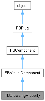

Property browsing. More...
#include <pyfbsdk.h>
Public Member Functions | |
| FBBrowsingProperty () | |
| Constructor. | |
| AddObject (FBPlug pObject) | |
| Add an object whose properties will be displayed. | |
| FBPlug | ObjectGet (int pIndex) |
| Return the object at the specified index. | |
| int | ObjectGetCount () |
| Get the number of object displayed in the property browser. | |
| RemoveObject (FBPlug pObject) | |
| Remove an object from the property browser. | |
