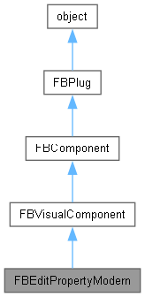

Inheritance diagram for FBEditPropertyModern:
