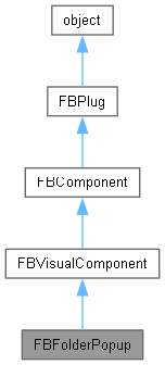

Folder Popup (for selecting a directory). More...
See samples: RenderLayers.py, BatchExportCharacterAnimationTool.py, RenameFirstTakeOnMultipleFiles.py, FBFolderPopup.py.
| FBFolderPopup | ( | ) |
Constructor.
| bool Execute | ( | ) |
Execute folder popup.
| str Caption |
Read Write Property: Caption to put in popup window.
| str Path |
Read Write Property: Path of folder selected.
