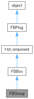

Objects Grouping class. More...
#include <pyfbsdk.h>

Public Member Functions inherited from FBBox | |

Public Member Functions inherited from FBComponent | |

Public Attributes inherited from FBPlug | |
This class is an interface to manipulate object's grouping in the scene.
