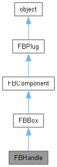

FBHandle class exposes the Handle object of the application. More...
This is a terminal class and should not be used as a base for a new class.
Public constructor.
This constructor is used to create a new object.
| pName | Object name. |
| Select | ( | ) |
Meta selection.
With this method, the handle itself is selected as well as all the models that are manipulated by the handle.
| FBListObject Follow |
List: Object to be followed by the handle. Should have a cardinality of 1.
| FBListObject Image |
List: Image to be used in the handle display. Only the image at position 0 is used.
| FBListObject Manipulate |
List: Objects manipulated by the handle.
| FBListObject ManipulateRotation |
List: Objects manipulated by the handle. Only their rotation is affected.
| FBListObject ManipulateScaling |
List: Objects manipulated by the handle. Only their scaling is affected.
| FBListObject ManipulateTranslation |
List: Objects manipulated by the handle. Only their translation is affected.
