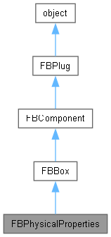

| | FBPhysicalProperties (str pName) |
| | FBBox (str pName) |
