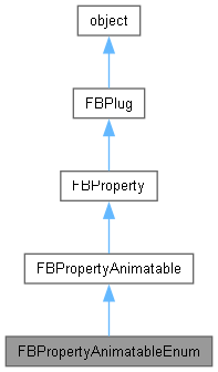

Inheritance diagram for FBPropertyAnimatableEnum:
