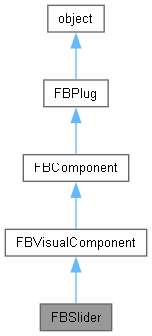

Slider. More...
#include <pyfbsdk.h>
Public Member Functions | |
| FBSlider () | |
| Constructor. | |
Public Member Functions inherited from FBVisualComponent | |
| FBVisualComponent () | |
| Constructor. | |
| bool | AddChild (FBVisualComponent pChild, int pId=0) |
| Add a child component. | |
| FBVisualComponent | GetChild (int pId=0) |
| Get a child component. | |
| QWidget | GetQWidgetAddress () |
| Get internal QWidget. | |
| bool | IsView () |
| Is component a view? | |
| Refresh (bool pNow=False) | |
| Refresh component. | |
| ViewExpose () | |
| Exposed view callback function. | |
| ViewInput (int pMouseX, int pMouseY, FBInputType pAction, int pButtonKey, int pModifier) | |
| Input callback function. | |
Public Member Functions inherited from FBComponent | |
| FBComponent () | |
| Constructor. | |
| str | ClassName () |
| Get the class name. | |
| DisableObjectFlags (FBObjectFlag pFlags) | |
| Disable a specific Object Flags. | |
| EnableObjectFlags (FBObjectFlag pFlags) | |
| Enable a specific Object Flags. | |
| bool | FBCreate () |
| Open Reality Creation function. | |
| FBDelete () | |
| Open Reality deletion function. | |
| FBDestroy () | |
| Open Reality destruction function. | |
| FBObjectFlag | GetObjectFlags () |
| Get all Object Flags (concatenated). | |
| bool | GetObjectStatus (FBObjectStatus pStatus) |
| Check to see if an object status is enabled. | |
| FBFileReference | GetOwnerFileReference (p0) |
| Get the owner FileReference object. | |
| HardSelect () | |
| HardSelect. | |
| bool | HasObjectFlags (FBObjectFlag pFlags) |
| Check whether a specific object flag is enabled. | |
| bool | Is (int pTypeId) |
| Returns true if object is of type TypeId. | |
| bool | ProcessNamespaceHierarchy (FBNamespaceAction pNamespaceAction, str pNamespaceName, str pReplaceTo=None, bool pAddRight=True) |
| ProcessNamespaceHierarchy. | |
| bool | ProcessObjectNamespace (FBNamespaceAction pNamespaceAction, str pNamespaceName, str pReplaceTo=None, bool pAddRight=True) |
| ProcessObjectNamespace. | |
| int | PropertyAdd (FBProperty pProperty) |
| Add a property to the component's property manager. | |
| bool | PropertyAddReferenceProperty (FBProperty pReferenceProperty) |
| Add a reference property to the component's property manager. | |
| FBProperty | PropertyCreate (str pName, FBType pType, str pDataType, bool pAnimatable, bool pIsUser=False, FBProperty pReferenceSource=None) |
| Create user or dynamic property. | |
| PropertyGetModifiedList (FBArrayTemplate< FB > pPropList, FBPlugModificationFlag pModificationFlags) | |
| Get list of properties which have been modified since last loading. | |
| PropertyRemove (FBProperty pProperty) | |
| Remove a Property from the component's Property manager. | |
| SetObjectFlags (FBObjectFlag pFlags) | |
| SetObjectFlags. | |
| SetObjectStatus (FBObjectStatus pStatus, bool pValue) | |
| Enable/Disable a specific Object Status. | |
Public Attributes | |
| float | Max |
| Read Write Property: Maximum value. | |
| float | Min |
| Read Write Property: Minimum value. | |
| FBEvent | OnChange |
| Event: Slider value changed. | |
| FBEvent | OnTransaction |
| Event: Transaction begin/end (continuous value changes). This event property doesn't exist in pyfbsdk. | |
| FBOrientation | Orientation |
| Read Write Property: Slider orientation. | |
| float | Value |
| Read Write Property: Current value. | |
Public Attributes inherited from FBVisualComponent | |
| str | RegionName |
| Read Write Property: Region name. | |
| int | RegionOffsetX |
| Read Write Property: Region X offset. | |
| int | RegionOffsetY |
| Read Write Property: Region Y offset. | |
| int | RegionOffsetWidth |
| Read Write Property: Region width offset. | |
| int | RegionOffsetHeight |
| Read Write Property: Region height offset. | |
| float | RegionRatioX |
| Read Write Property: Ratio for X attachment. | |
| float | RegionRatioY |
| Read Write Property: Ratio for Y attachment. | |
| float | RegionRatioWidth |
| Read Write Property: Ratio for Width attachment. | |
| float | RegionRatioHeight |
| Read Write Property: Ratio for Height attachment. | |
| FBAttachType | RegionAttachTypeX |
| Read Write Property: X Attachment type. | |
| FBAttachType | RegionAttachTypeY |
| Read Write Property: Y Attachment type. | |
| FBAttachType | RegionAttachTypeWidth |
| Read Write Property: Width Attachment type. | |
| FBAttachType | RegionAttachTypeHeight |
| Read Write Property: Height Attachment type. | |
| FBVisualComponent | RegionAttachToX |
| Read Write Property X Attachment source. | |
| FBVisualComponent | RegionAttachToY |
| Read Write Property: Y Attachment source. | |
| FBVisualComponent | RegionAttachToWidth |
| Read Write Property: Width Attachment source. | |
| FBVisualComponent | RegionAttachToHeight |
| Read Write Property: Height Attachment source. | |
| int | RegionPosMaxX |
| Read Write Property: Region X position Max | |
| int | RegionPosMinX |
| Read Write Property: Region X position Min | |
| int | RegionPosMaxY |
| Read Write Property: Region Y position Max | |
| int | RegionPosMinY |
| Read Write Property: Region Y position Min | |
| str | BorderCaption |
| Read Write Property: Caption to display in border. | |
| bool | BorderShowCaption |
| Read Write Property: Show caption? | |
| FBBorderStyle | BorderStyle |
| Read Write Property: Style of border. | |
| bool | BorderInSet |
| Read Write Property: Is border inset? | |
| int | BorderWidth |
| Read Write Property: Width of border. | |
| int | BorderSpacing |
| Read Write Property: Spacing of border. | |
| float | BorderMaxAngle |
| Read Write Property: Max angle for rounding. | |
| int | BorderCornerRadius |
| Read Write Property: Corner radius (rounded). | |
| str | Caption |
| Property: Widget caption. | |
| bool | Enabled |
| Read Write Property: Is visual enabled? | |
| int | Height |
| Read Write Property: Height. | |
| str | Hint |
| Read Write Property: Hint to show. | |
| int | Left |
| Read Write Property: Left coordinate. | |
| bool | ReadOnly |
| Read Write Property: Is visual component read only? | |
| int | Top |
| Read Write Property: Top coordinate. | |
| bool | Visible |
| Read Write Property: Is visual component visible? | |
| int | Width |
| Read Write Property: Width. | |
Public Attributes inherited from FBComponent | |
| FBListComponent | Components |
| List: List of components. | |
| str | LongName |
| Read Write Property: Name and namespace for object. | |
| str | Name |
| Read Write Property: Unique name of object. See sample: RemoveSuffixFromNameOfSceneElements.py. | |
| FBListComponent | Parents |
| List: Parents. | |
| FBManager | PropertyList |
| Read Only Property: Manages all of the properties for the component. | |
| bool | Selected |
| Read Write Property: Selected property. | |
| int | TypeInfo |
| Contains the Type information of the object. | |
Public Attributes inherited from FBPlug | |
| str | ClassGroupName |
| ClassGroupName of the object. | |
| int | TypeInfo |
| TypeInfo. | |
| FBSlider | ( | ) |
Constructor.
| float Max |
| float Min |
| FBEvent OnChange |
| FBEvent OnTransaction |
| FBOrientation Orientation |
| float Value |
