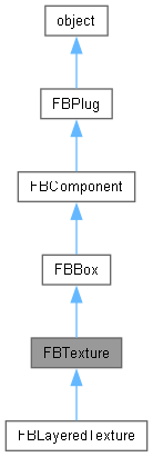

Public Member Functions | |
| FBTexture (str pName) | |
| Constructor. | |
| FBTexture | Clone () |
| Clone the texture. | |
| FBDelete () | |
| OGLInit (FBRenderOptions pRenderOptions=None) | |
Public Member Functions inherited from FBBox | |
| FBBox (str pName) | |
| Constructor. | |

Public Member Functions inherited from FBComponent | |
| FBComponent () | |
| Constructor. | |
