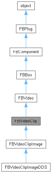

Video clip media class. More...
#include <pyfbsdk.h>

| FBVideoClip | ( | str | pName | ) |
Constructor.
| pName | Name of video media. |
