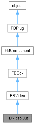

Video media class. More...
#include <pyfbsdk.h>
Public Member Functions | |
| FBVideoOut () | |
| Constructor. | |
Public Member Functions inherited from FBVideo | |
| FBVideo (str pName) | |
| Constructor. | |
