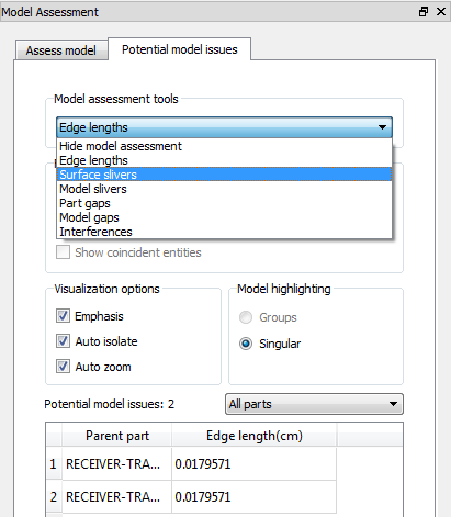

  1. Select Surface Slivers from the Model assessment tools drop-down menu.
    surface silvers

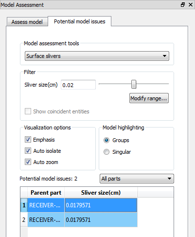

  2. Select one of the potential model issues.
    model assessment dialog

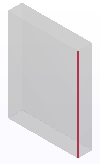

    Note: As expected, we are looking at the surface created by the small edges that we observed previously. When dealing with larger geometry sets, these surfaces may vary from what we can see in the small edges.
    surface sliver view
