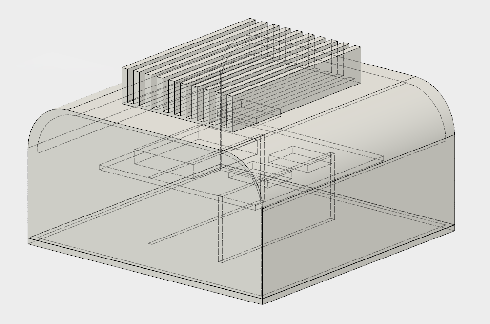

In this tutorial, we observe geometry coming into Autodesk® CFD. The issues in the geometry will then be assessed using the Model Assessment Toolkit (MAT).
The geometry shown was created to show the behavior of some of the most common geometry issues. We will investigate the affects of these problems in Autodesk® CFD as well as learn how to find them using the Model Assessment Toolkit.
