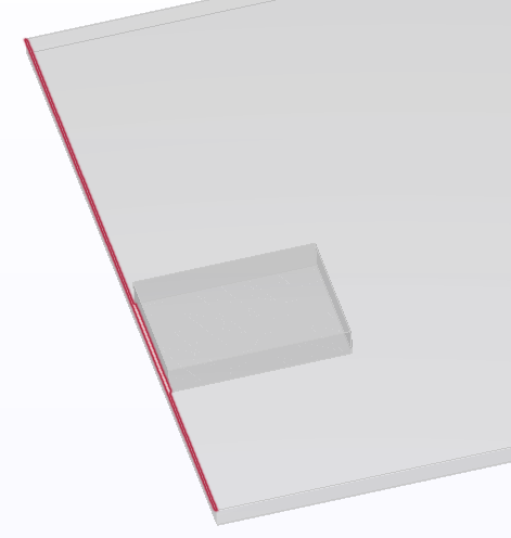

In the following steps we will be looking at the Model Slivers in the model. When an assembly is imported/launched into Autodesk® CFD the contact between two parts creates a single surface that the two parts share. This can cause a sliver surface to be created that was not in the initial CAD model. Unintentional surface slivers can lead to poorly formed mesh elements, or a high element count, or meshing failures. These effects can lead to longer runtimes and may be difficult to troubleshoot.

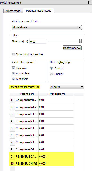

Right-click in the graphics window to bring up the context menu and select Model Slivers.
Click through the Parent Part list.
Adjust the filter to 0.03 cm by typing it in the dialog box and click Enter.
Select one of the new entries from the table.
More about Model Slivers in the Model Assessment Toolkit.
