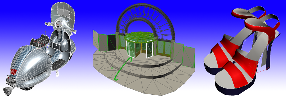

Three types of surface models: patch (left); mesh (center); NURBS (right)
