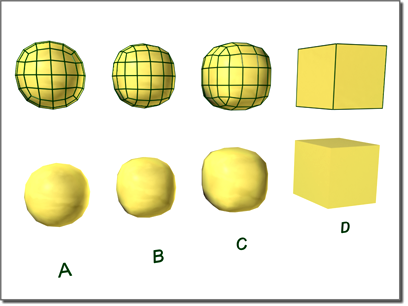

Effect of MeshSmooth with two iterations on a cube and different iteration method:
A. NURMS
B. Quad
C. Classic
D. Original object with no MeshSmooth
