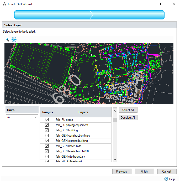

Select Layer
This step allows layers of the CAD file to be turned off before loading, as well as setting the units of the file, providing a preview image of the file, and additional options when loading surface data.
Toolbar
At the top of the page is a toolbar containing controls for the preview image.
Band Zoom: Clicking this icon lets users zoom into a specified area of the drawing using the Band Zoom tool.
View Extents: Zooms out the viewing window  to full size extents.
Preview Image
The preview image will display the layers of the CAD file which are selected in the layers grid. The view can be moved by clicking and dragging with either the left or middle mouse button. The view can be zoomed in and out with the scroll wheel. The size of the preview image can be changed by left clicking and dragging the bottom edge.
Units
Select the units for the DXF/DWG being loaded so that it can be converted for use with the current units within the software.

Layers Grid
The grid is used to select which layers are displayed in the preview image, and therefore brought in to the design after clicking Finish.
Areas / Images / Surface Data: This is the first column of the grid. The header of this column is dependant on what the CAD file is being loaded into. The check boxes in this column determine if a layer will appear in the preview image loading.
Layers: The names of the layers in the CAD file.
If importing a CAD file previously exported from InfoDrainage, you may see a layer titled XPS_StormwaterControlChambers. This layer contains all of the internal Chamber sub-outlines, and should not be used to import Stormwater Controls or Inflows. The full outlines of all Stormwater Controls are contained in the XPS_StormwaterControl layer.

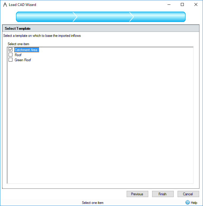

Select Template
When using the Load CAD Wizard to load areas of either stormwater controls, inflows, or Land Uses, a third step will appear in the wizard. This step allows the selection of a template which the imported areas will be based on.
When loading junctions the third step in the wizard will allow the selection of a template to base the imported junctions on.
When loading connections the third step in the wizard will allow the selection of a template to base the imported connections on. A fourth step will allow the selection of a template to base the junctions created to support connection endpoints on.
When loading pipe network(s) there will be steps for selecting both the junction and connection type to base imported items on.
When loading Soil Types, this section is skipped. Soil Types do not have object templates.
