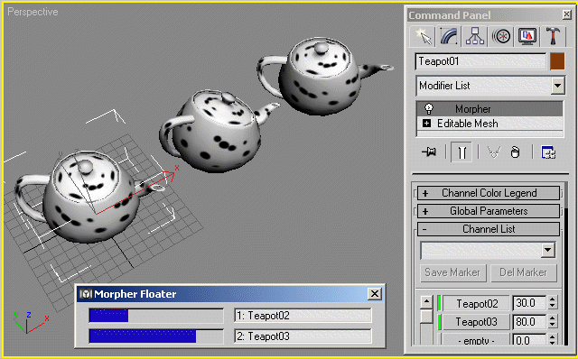

Using the Script
Evaluate the script. To use it, you can use Customize... to drag the script from the category "HowTo" to a toolbar, a menu, a quad menu or to assign to a keyboard shortcut.
Select a single object with a Morpher modifier and some active channels in the scene and execute the script. A new floating dialog should appear showing a progress bar and a text field displaying the channel number and the target name.
