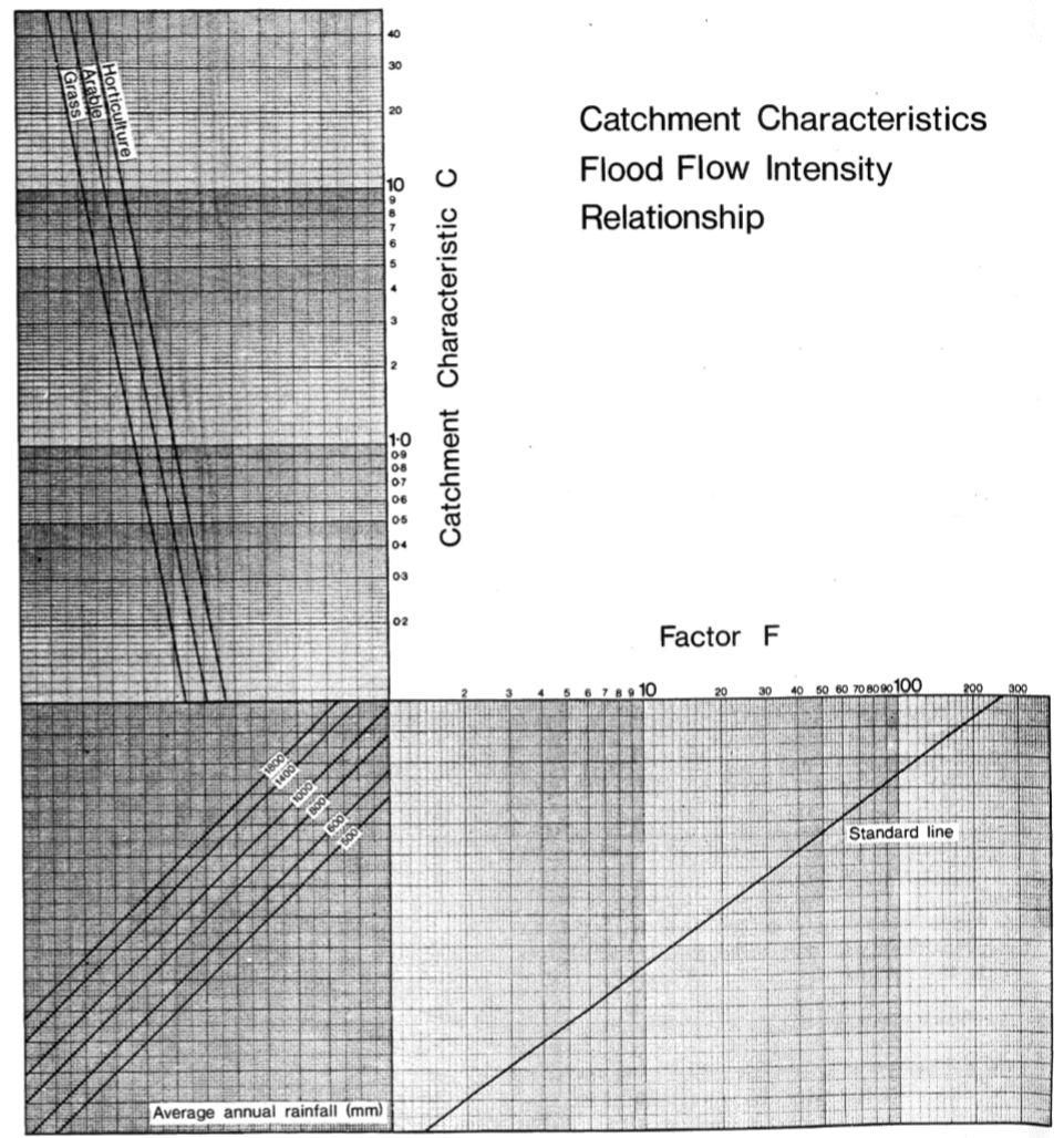

F: Number derived from a lookup process outlined below:
Catchment Characteristic C
This is then used along with the selected crop type and average annual rainfall to determine the image from the graph below:
The image above has been copied from 'The design of field drainage pipe systems' ADAS Reference Book 345.

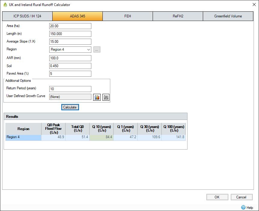

Area - Catchment area.
Length - The maximum length of the catchment.
Average Slope - Average slope of catchment (height/length).
Region - Region number of the catchment based on FSR Figure I.2.4. This can be selected from the Region Picker.
AAR - The average rainfall.
Soil Type - Determine the soil type factor ST.

Paved Area - Percentage paved but not exceeding 10%.
Additional Options
Return Period - Rainfall return period between 1 and 1000 years.
Growth Curve - Click the Growth Curve Details icon to open the Growth Curve Editor.
Q0 - Peak flood flow for 2-year return period.
Total Q - Peak flood flow including Paved area for 2-year return period.
