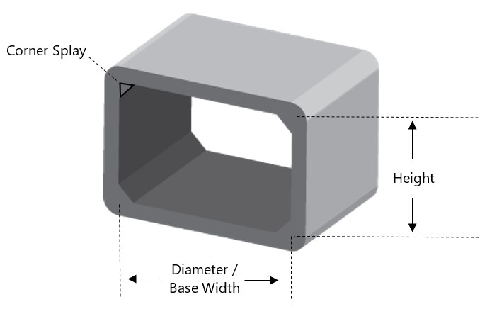

Box Culvert Connection is a closed connection with a rectangular cross-section. However, increasing the Corner Splay value from “0” (default) gives the Box Culvert an increasingly octagonal shape. A Corner Splay can be introduced for pipe strengthening purposes. The flow routing through a Box Culvert Connection is described in Analysis of Junctions and Connections.
As illustrated in the image above, the addition of a Corner Splay reduces the Diameter/Base Width and Height of the connection to an extent, affecting its Capacity and Flow Velocity.
