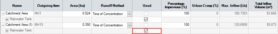

This is the component where the objects and their properties are displayed. Tables is a multidimensional view. It reflects data that you can access from the editor form of each items. Data is sorted and hierarchised to simplify browsing through the different parameters of items available in your design. As an example, a Junction would be shown as below:
In this case, any Inlets are not listed in the "Manhole" row but underneath in the "Inlets" sub-row; this helps categorising values and having a better visualisation of the data.
