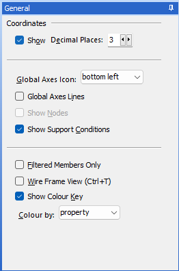

This side toolbar allows the user to define what annotation, axes sets and node positions are to be shown in the graphic view of the structure.
Outline Procedure
Click on the General tab on the right hand side of the graphic window. This toolbar will fly out.
Check one or more of Joint, Member or Result boxes to identify the items to be annotated. Pick the appropriate Format box to open the Text Setup Form to define and format the text to be applied to those items.
Check the boxes and set the fields for Show Global Axes, Show Local Axes, Show Nodes, Transparent Model, Grid, Coordinates and Filtered Members only.
Only those selections that can be applied in a given context are shown.
In the special case of Assign Section Data a 'Switch' button allows the 'Annotation: Member' field to be changed to 'Annotation: Section Data Set' and vice versa.

General Toolbar Graphic

Global Axes
Check this box to show the global axes icon. The 3D Elements View has the additional option to show global axes lines.
Local Axes
Check this box to show the local axes set for every member/element.
Show Nodes
Check this box to show a dot at every node position.
Show Support Conditions (3D Elements View only)
Check this box to show graphical representations of the support conditions below each support.
Check this box to show only those members that are included in the current Member Selection Filter.
Transparent Model / Wire Frame View (Ctrl-T)
Removes the rendering on Finite Elements, showing only their edges. Always inactive in the Tabular Results form.
Show Colour Key (3D Elements View only)
A colour key can be shown when Colour by is set to sub model or property. This key will assist in matching the colour of the sub model group or property group to the name of the group.
Colour by (3D Elements View only)
Select one of the following options to change the colour scheme for the 3D elements:
Element Description
sub model Each 2D or 3D sub model is shown in a different colour.
property The colour scheme is shown according to the assigned structure property.
elasticity The colour scheme is based on member elasticity.
member Each member is shown in a different colour.
