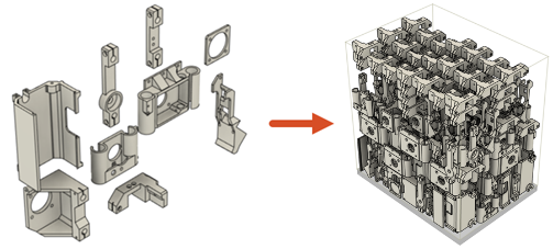

Components in the Design workspace (left), then duplicated and arranged in the HP Jet Fusion 5000 printer in the Manufacture workspace (right).
