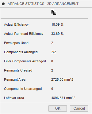

The information that appears in the dialog depends on the type of arrangement you are viewing. Example of the Arrange Statistics dialog for a 2D arrangement:
arrange statistics dialog for a 2D arrangement

Statistics for a 2D arrangement
Statistic Definition
Actual Efficiency Represents the portion of the envelope area used by the arranged components.
Actual Remnant Efficiency Represents the portion of the envelope area used by the arranged components, excluding remnants. This value is only available for rectangular envelopes.
Envelopes Used Represents the number of envelopes used to fit the arranged components.
Components Arranged Represents how many required components have been arranged, excluding fillers.
Filler Components Arranged Represents the total number of filler components in the arrangement. Filler components fill up any extra space in the envelope after the non-filler components have been arranged.
Remnants Created Represents number of created remnants. This value is only available for rectangular envelopes.
Remnant Area Represents the unused area of the envelope that can be trimmed off with a single vertical cut. This value is only available for rectangular envelopes.
Components Unarranged Represents the number of required components that could not fit in the arrangement due to specified arrangement settings.
Leftover Area Represents the total unused material area across all envelopes.
