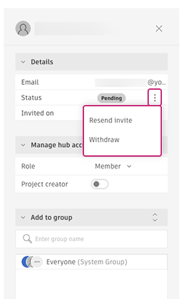

Resend or withdraw invitations
  1. In the Members and Groups tab, click the name of a member with the status Pending.
    A side panel with the member's details opens.
  2. In the Details section, hover over the status field and click More more icon.
    withdraw or resend
  3. Choose Resend invite or Withdraw.
If you resend the invitation, the member receives a new invite email. If you withdraw the invitation, the member will be removed from the list and will no longer be able to accept the original invitation. If they try to do so, they will receive an error message.
