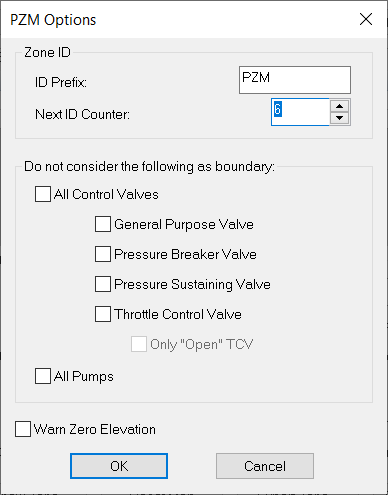

    1. First let's make sure the options are set appropriately. Click Options.
    2. The Options button controls global options for the Pressure Zone Manager.
    3. Several options can be set including whether to exclude valves or pumps as zone boundaries.  For this example, you will include all valves and pumps as boundaries.  Ensure all options are set in PZM options dialog box.
      PZM Options Description
      Zone ID Sets default values for the Zone ID.
      ID Prefix Enter the zone name prefix in this field.
      Next ID Counter Use this field to increment the counter ID.
      Do not consider the following as boundary Check boxes to select valves or pumps to exclude as zone boundaries.
      Exclude all control valves Use this check box to exclude all control values.
      General Purpose Valves Only Use this check box to mark for General Purpose Values only.
      Pressure Breaker Valve Use this check box to mark for Pressure Breaker Valve.
      Pressure Sustaining Valve Use this check box to mark for Pressure Sustaining Valve.
      Throttle Control Valve Use this check box to mark for Throttle Control Valve.
      Warm Zero Elevation Use this option to checks for junctions with no or zero elevation data if checked.
    4. Click OK.

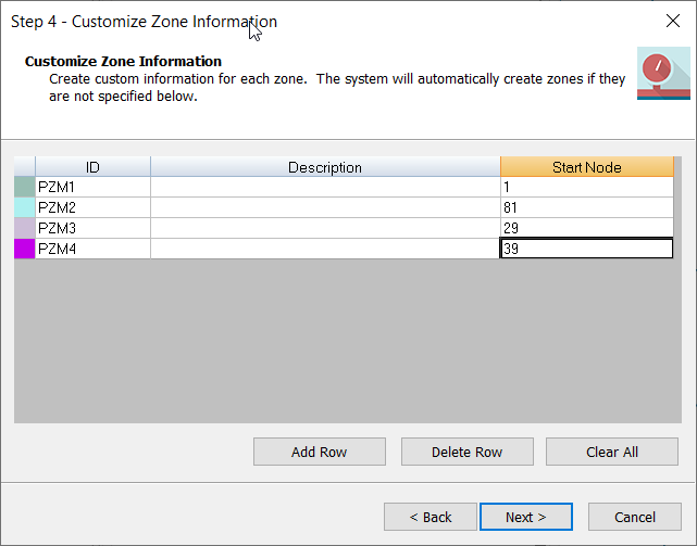

    13. The Customize Zone Information dialog box allows you to suggest zones and customize zone information. Let's suggest a zone.
    14. Click Add Row. View Customize Zone Information dialog box.
    15. Click in the cell in the Description field and type "Tank Zone".
    16. Double click on the color box on the far left and choose Magenta.
    17. Double click in the cell in the Start Node field.  Select the junction between the reservoir and the pump.  Your Wizard should look something like this:
    18. Click Next.

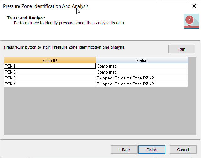

    19. The Pressure Zone Identification and Analysis is the final part of the wizard.  Click Run.
    20. Your results should look something like this:
    21. If you have trouble with tracing any of your network in your wizard, you will be notified in the Status field.
    22. You are now finished tracing the network. Click Finish to get back to the Pressure Zone Manager.

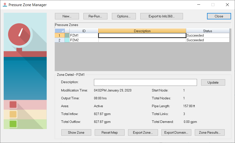

    1. Run your wizard. Your dialog box should look like this:
    2. Double-click the color box for the second zone and choose a color to visually identify the zone.
    3. Click in the Description box in the Zone Detail area. Type a description and click Update to update the description for the zone.
    4. Repeat the previous two steps for the second zone. Your dialog box should have descriptions for your pressure zones as shown below.

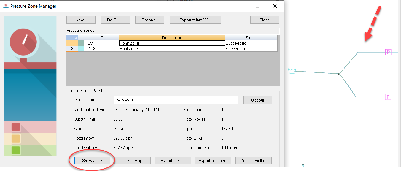

    6. Click the "Tank Zone" zone in the PZM and click Show Zone.  This will temporarily color the pipes identified for the "Tank Zone" and zoom in your display so you can see them better.  Your screen should look something like this:
    7. Repeat the previous step to inspect the second zones. Multiple zones can be selected before clicking on the Show Zone button.
    8. At any time you can click on the Reset Map button to reset the map display to the default colors.
