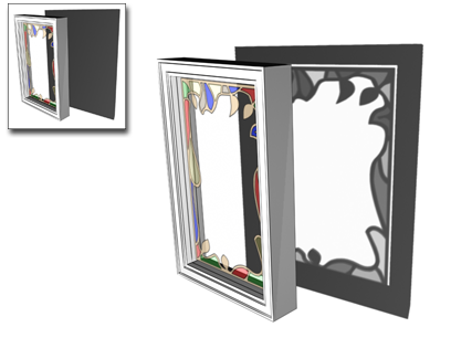

Transparent Shadows group
- On
- When checked, transparent surfaces will cast a colored shadow. Otherwise, all shadows are black.
Note: Shadows will generate faster with this value turned off.
A stained glass appears solid with the transparency optimization turned off.
