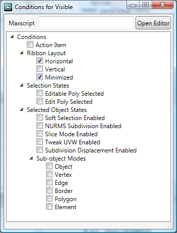

Use the Conditions dialog to set conditions for enabling ribbon elements and controls or making them visible. The full name of the dialog is Conditions For Enabled, Conditions For Visible, or Conditions for Available, depending on the Customize Ribbon dialog property from which you invoked it.

If you set multiple conditions, keep in mind that when any condition for a particular state, such as the ribbon layout, is met, it causes the condition to be satisfied.
For example, the Polygon Modeling panel has two different “poly main” sub-panels available. One of the “poly main” sub-panels has its Visible property set to Conditional: Horizontal (which implies maximized) or Minimized, which applies to either horizontal or vertical.
The other sub-panel is set to Conditional: Vertical, which applies to the maximized vertical ribbon. When setting up different versions of a panel or sub-panel for different ribbon configurations, make sure the conditions for visibility don’t overlap.
However, if you set multiple conditions for different states, such as ribbon layout and active sub-object level, at least one condition in each state must be met for the condition to be satisfied.

The Conditions dialog offers a list of checkboxes for choosing preset conditions for ribbon elements; you can also custom-tailor a condition using MAXScript.

Conditions
Action Item
Applies when a particular toggle command is active. For example, the Soft panel, which provides controls for modifying how Soft Selection works, is available only when the Use Soft Selection command is active.
When you click this item, a dialog opens that lets you choose an action item to define the condition. The dialog is organized the same way as the Action Items window on the Customize Ribbon dialog. Find the command and then double-click it to apply it to the Action Item condition. The command’s name then appears in parentheses next to “Action Item” on the dialog.
Ribbon Layout
Horizontal
Applies when the ribbon orientation is horizontal and maximized.
Vertical
Applies when the ribbon orientation is vertical and maximized.
Minimized
Applies when the ribbon is minimized.
Selection States
Typically, if you enable either of these, enable the other as well. This is the case for the Available property in most panels on the Graphite Modeling Tools, Freeform, and Selection tabs on the ribbon.
Editable Poly Selected
Applies when a single editable poly object is selected and .3ds Max is in Modify mode.
Edit Poly Selected
Applies when a single Edit Poly object (that is, an object with the Edit Poly modifier applied) is selected and .3ds Max is in Modify mode.
Selected Object States
Soft Selection Enabled
Applies when Use Soft Selection on the Polygon Modeling panel is active.
NURMS Subdivision Enabled
Applies when Use NURMS on the Edit panel is active.
Slice Mode Enabled
Applies when the Slice Plane tool on the Geometry (All) panel is active.
Tweak UVW Enabled
Applies when Tweak on the Edit panel is active.
Subdivision Displacement Enabled
Applies when Use Displacement on the Subdivision panel is active.
Sub-object Modes
Object
Applies when no sub-object level is active.
Vertex
Applies at the Vertex sub-object level of editable poly and Edit Poly objects.
Edge
Applies at the Edge sub-object level of editable poly and Edit Poly objects.
Border
Applies at the Border sub-object level of editable poly and Edit Poly objects.
Polygon
Applies at the Polygon sub-object level of editable poly and Edit Poly objects.
Element
Applies at the Element sub-object level of editable poly and Edit Poly objects.
