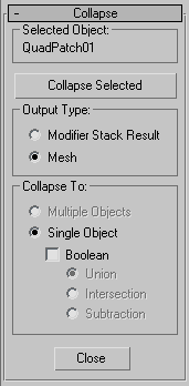

Interface
Selected Object group
Displays the name of the current selection. If more than one object is selected, "[Number] Objects Selected.” displays.
- Collapse Selected
- Collapses the selected objects. The method of collapse depends on the settings of the options below this button.
Output Type group
Specifies the type of object that results from the collapse.
- Modifier Stack Result The resultant object will be the same as if you had collapsed its stack. In most cases, this results in a mesh object, as when using the Mesh option. However, if the object has an Edit Patch modifier so that its stack produces a patch, then the result will be a patch object rather than a mesh. Likewise, a shape with Edit Spline modifiers becomes an editable spline. When this option is used, the Collapse To options are unavailable, and all selected objects remain independent objects.
- Mesh All selected objects become editable meshes regardless of their type before they were collapsed.
Collapse To group
Specifies how the selected objects are combined. These options are available only when you choose the Mesh option.
- Multiple Objects Collapses each object in the selection but maintains each as an independent object. When this option is chosen, the Boolean options are disabled.
- Single Object Collapses all selected objects into a single editable mesh object.
Boolean When on, performs Boolean operations on the selected objects. During the Boolean calculation, a progress bar appears along with a Cancel button. If any objects in the Boolean operation fail, that object is skipped, but the Collapse proceeds. The result is not a Boolean compound object, but a single editable mesh. The type of Boolean is specified by the following choice:
- Union Combines the several objects, removing intersecting geometry.
- Intersection Removes all but the intersecting geometry.
- Subtraction Maintains the first object selected while subtracting the subsequently selected objects. For example, to subtract several cylinders from a box, click to select the box, hold down
- Ctrl, and region-select the cylinders.
- Close
Exits the Collapse utility.
