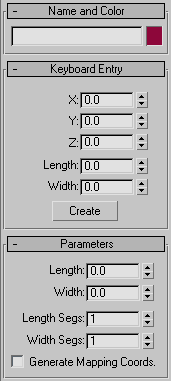

Interface
Name and Color rollout
The Name and Color rollout lets you rename objects and change their wireframe color.
Keyboard Entry rollout
- X/Y/Z
Sets the patch center.
- Length
Sets the patch length.
- Width
Sets the patch width.
- Create
Creates a patch based on the XYZ, Length, and Width values.
Parameters rollout
- Length, Width
Sets the grid dimensions in current units.
- Length, Width Segments
Determines the number of facets along the length and width of the grid. Default=1.
The density of a Quad Patch rises sharply as you increase the segments. A Quad Patch of two segments on a side contains 288 faces. The maximum is 100 segments. High segment values can slow performance.
- Generate Mapping Coordinates
Creates map coordinates for applying mapped materials. Default=off.
