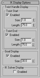

IK Display Options rollout
The options on this rollout set the display of twist manipulators and the IK chain object.
Tip: To see and adjust the twist manipulators, turn on Select And Manipulate.
Twist Start group
- Enabled
- Turns on the display of the start twist manipulator. Default=on.
- Size
- Sets the size of the start twist manipulator. Default=1.0.
- Length
- Sets the length of the start twist manipulator. Default=75.0
Twist End group
- Enabled
- Turns on the display of the end twist manipulator. Default=on.
- Size
- Sets the size of the end twist manipulator. Default=1.0.
- Length
- Sets the length of the end twist manipulator. Default=75.0.
Goal Display group
- Enabled
- Turns on the display of the IK goal. Default=on.
- Size
- Sets the size of the IK goal. Default=30.0.
IK Solver Display group
- Enabled
- Turns on the display of the IK chain object. Default=off.
