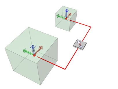

Once two objects are linked together, the child object maintains its position, rotation, and scale transforms relative to its parent object. These transforms are measured from the pivot of the parent to the pivot of the child.
For example, consider the two boxes in the following figure. The larger box is the parent of the smaller. The pivots and link between the boxes are indicated to show how the link works. The link extends from the pivot of the parent and connects to the pivot of the child. You can think of the child’s pivot as being the joint between the parent and child.
Parent and child objects linked by their pivot points.

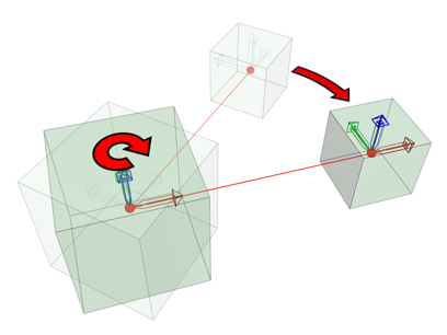

Rotating the parent affects the position and orientation of the child object.
Rotating the child does not affect the parent.
Links act as a one-way conduit to transmit the transforms of a parent object to its child object. If you move, rotate, or scale the parent, the child is moved, rotated, or scaled by the same amount. Because hierarchical links are one-way, moving, rotating, or scaling the child has no effect on its parent.

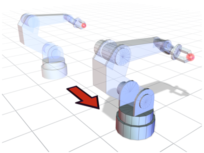

Moving the root parent moves the whole hierarchy.

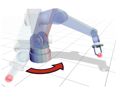

Rotation of a parent object is passed to all the child objects.

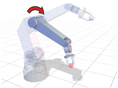

Rotating a child object in the middle of the hierarchy affects all the descendants but none of the parents.

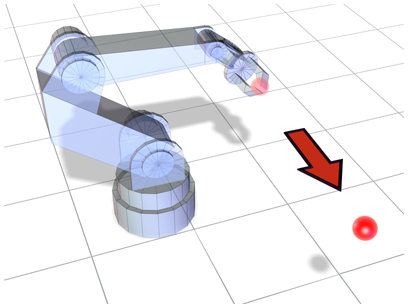

If you want to manipulate parent objects by moving the last child in the chain, use inverse kinematics.
