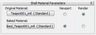

Interface
- Original Material
Displays the name of the original material. Click the button to view that material and adjust its settings.
- Baked Material
Displays the name of the baked material. Click the button to view that material and adjust its settings.
In addition to the coloring and maps used by the original material, the baked material can include shadows from lighting, and other information. Also, a baked material has a fixed resolution.
- Viewport
Use these buttons to choose which material appears in shaded viewports: the original material (upper button) or the baked material (lower button).
- Render
Use these buttons to choose which material appears in renderings: the original material (upper button) or the baked material (lower button).
