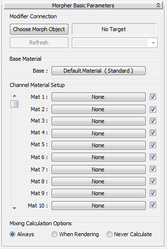

The Morpher material interface is on a Parameters rollout in the Material Editor.
Modifier Connection group
- Choose Morph Object
- Click this option, then select an object in the viewports that has a Morpher modifier applied to it. Clicking an object in the viewports displays the Choose Morpher modifier dialog. Choose a Morpher modifier, and click Bind.
- [name field]
Displays the name of object to which the Morpher material is applied. If no object has been specified, the field displays "No Target".
- Refresh
- Updates the channel data.
- [marker drop-down list]
This list is identical to the marker list in the Morpher modifier. Markers you save in the Morpher modifier appear here.
Base Material group
- Base material button
- Click to apply a base material to the object. The base material represents what the model looks like before any channel blending takes place.
Channel Material Setup group
- Map #
- 100 material channels are available. The scroll bar allows you to scroll through all the channels. Double-click a channel to jump to the material parameters for that channel.
There is a one-to-one correspondence between the channels in the Morpher material and the Morpher modifier. A material in channel 1 of the Morpher material is controlled by the channel 1 spinner in the Morpher modifier.
- Material on/off toggle
- Turns a channel on and off. Channels that are off do not affect the morph result.
Mixing Calculation Options group
3ds Max can slow down if many active materials are being blended. Options in this group allow you to control when the morph result will be computed.
- Constantly Choose to compute the material morph result all the time.
- When Rendering Choose to compute the material morph result at render time.
- Never Calculate Choose to bypass material blending.
