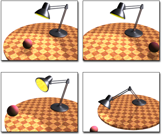

Use the binding functions in the HD Solver to cause an object to attempt to maintain its position and orientation relative to the world or to another object. A bound object will resist motion in the kinematic chain until the chain is stretched near its limits and the bound object must move to complete the IK solution.
In the top row, the ball is independent of the lamp. In the bottom row, the lamp head is bound to the ball's position.
