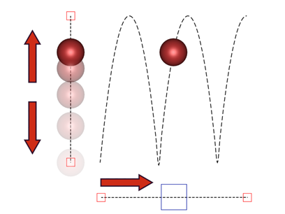

Consider a bouncing ball that moves along a path. You could animate the ball by positioning it on many frames, but it would be very difficult for you to go back and adjust the height of the bounce or the path of the ball. You have to edit the motion of the ball on many frames to make even a simple change.
Using a dummy object solves this problem by breaking the motion into simple components. One component is the up and down bounce of the ball. The other is movement on the path.
Combining the bouncing motion of a ball with the forward motion of a dummy results in a moving bouncing ball.

Example: To create a complex bounce motion using a dummy object:
- Start with a sphere, then create a dummy object below the sphere, and
link the sphere as a child of the dummy. - Animate the sphere bouncing up and down above the dummy.
- Animate the dummy moving.
The sphere bounces on top of the dummy object as the dummy moves around the scene. You can easily change the height and speed of the bounce by changing the sphere animation. You can change the path through the scene by changing the dummy animation.
