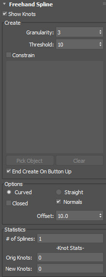

Freehand Spline rollout, Create mode
Rollout shown before spline is drawn.
- Show Knots
- Displays knots on the spline.
Create group
- Granularity
- The number of cursor position samples taken before a knot is created.
- Threshold
- Sets how far the cursor must move before a new knot is created. A higher value increases the distance.
- Constrain
- Constrains the spline to selected objects in the scene.
- Pick Object button
- Enables Object Selection mode for constraining objects. When you have finished picking objects, click again to complete the operation.
- Clear
- Clears the list of selected objects.
- End Create On Button Up
- When enabled, creates a Freehand spline when the mouse button is released. When disabled, the shape is continued when the mouse button is pressed again, automatically connecting the open end of the spline; you must press Esc or right-click in the viewport to finish drawing.
Options group
- Curved/Straight toggle
- Sets whether the segments between knots are curved or straight.
- Closed
- Draws a line between the beginning and the end of the spline to close it.
- Normals
- Shows the resulting normals of the constrained spline in the viewport.
- Offset
- Offsets the position of the hand-drawn spline away from the surface of the constraining object.
Statistics group
- Number of Splines
- Displays the number of splines in the shape.
- Original Knots
- Shows the number of knots automatically created while drawing the spline (0 before drawing).
- New Knots
- Shows the new number of knots (0 before drawing).
Freehand Spline rollout, Modify mode
Rollout shown once the spline has been created.
- Show Knots
Options group
- Sampling
- Sets the sampling amount. Values greater than zero progressively reduce neighboring knots, smoothing the result.
- Closed
- Normals
- Offset
Statistics group
- Number of Splines
- Orig Knots
- Shows the number of knots automatically created while drawing the spline.
- New Knots
