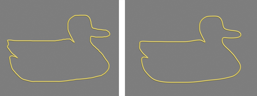

The Spline Relax modifier smooths out splines by relaxing knot positions and/or handles.
Tip: This modifier is compatible with soft selections.
Freehand spline illustration of a ducky, before (left) and after (right) application of Spline Relax modifier.
