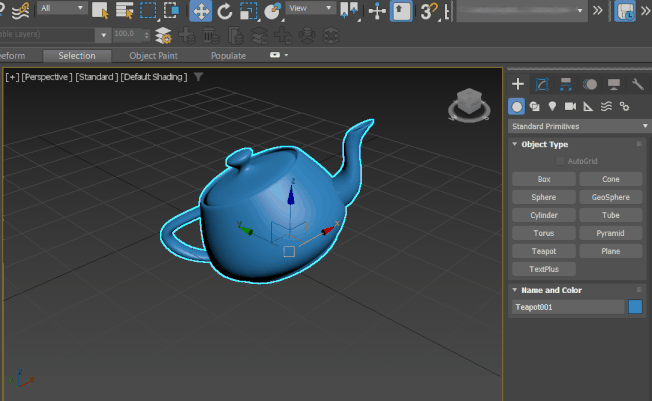

To reposition an object's pivot point:
Select an object and then turn on
Hierarchy panel
Adjust Pivot rollout
Affect Pivot Only.
Move or
rotate the pivot.
You can also use Align, Quick Align, and Align to View on the toolbar to align the pivot.
See Adjust Transform Rollout for related information.
