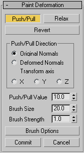

Interface
Paint Deformation has three modes of operation: Push/Pull, Relax, and Revert. Only one of these modes can be active at a time. The remaining settings control the effect of the active deformation mode.
For any mode, choose the mode, change settings as necessary, and then drag the cursor over the object to paint the deformation.
To paint deformation anywhere on the object, remain at the object level, or work at a sub-object level with no sub-objects selected. To deform only specific areas of an object, go to a sub-object level and select the sub-objects in the area to deform.
Push/Pull
Moves vertices into the object surface (push) or out of the surface (pull). The direction and extent of pushing or pulling is determined by the Push/Pull Value setting.
Tip: To reverse the Push/Pull direction while painting, press and hold Alt.
Note: Push/Pull supports soft selection in that effective strength falls off with the selection value of soft-selected sub-objects.
Relax
Normalizes the distances between vertices by moving each vertex to a position calculated from the average of its neighbors. Relax uses the same method as the Relax modifier.
Use Relax to push apart vertices that are too close together, or to pull together vertices that are too far apart.
Revert
Lets you gradually “erase” or reverse the effects of Push/Pull or Relax by painting. Affects only vertices deformed since the most recent Commit operation. If no vertices qualify for reversion, the Revert button is unavailable.
Tip: You can switch to Revert mode temporarily by pressing and holding the Ctrl key while painting deformation in Push/Pull or Relax mode.
Push/Pull Direction group
This setting lets you specify whether pushing or pulling vertices occurs with respect to surface normals, original or deformed, or along a specific axis. Default=Original Normals.
Painting deformations with Original Normals typically moves vertices perpendicular to the original surface; using Deformed Normals tends to move vertices outward after their initial deformation, resulting in a “puffy” effect.
Original Normals
When chosen, pushing or pulling a vertex moves it in the direction of its normal before deformation. Repeated applications of Paint Deformation always move each vertex in the same direction it moved originally.
Deformed Normals
When chosen, pushing or pulling a vertex moves it in the current direction of the normal; that is, after deformation.
Transform axis X/Y/Z
When chosen, pushing or pulling a vertex moves it along the specified axis, using the current reference coordinate system.
Push/Pull Value
Determines the direction and maximum extent of a single application of the push/pull operation. Positive values “pull” vertices out of the object surface, and negative values “push” vertices into the surface. Default =10.0.
A single application is defined as painting (that is, dragging once or more over the same area) without lifting the mouse button.
Tip: You can use Alt to switch between pushing and pulling with the same value while painting. For example, if you're pulling with a value of 8.5, press and hold Alt to start pushing with a value of –8.5.
Brush Size
Sets the radius of the circular brush. Only vertices inside the brush circle are deformed. Default=20.0.
Tip: To change the brush radius interactively, release the mouse button, press and hold Shift+Ctrl + the left mouse button, and then drag the mouse. This also works with all other painter-interface features in 3ds Max such as Skin Paint Weights and VertexPaint.
Brush Strength
Sets the rate at which the brush applies the Push/Pull value. A low Strength value applies the effect more slowly than a high value. Range=0.0 to 1.0. Default=1.0.
Tip: To change the brush strength interactively, release the mouse button, press and hold Shift+Alt + the left mouse button, and then drag the mouse. This also works with all other painter-interface features in 3ds Max such as Skin Paint Weights and VertexPaint.
Brush Options
Click this button to open the Painter Options dialog, where you can set various brush-related parameters.
Commit
Makes any deformation changes permanent, “baking” them into the object geometry. After using Commit, you can no longer apply Revert to changes up to that point.
Cancel
Eliminates all changes since the initial application of Paint Deformation or the most recent Commit operation.
