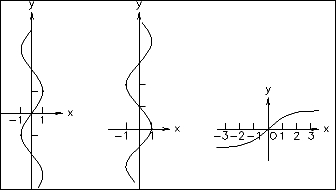

The sine and cosine functions yield the same values, but the phase differs along the X axis by π/2: in other words, 90 degrees.
The inverse functions for the trigonometric functions are the arc functions; the inverse applies only to values of x restricted by –π/2 ≤ X ≤ π/2. The graphs for these functions appear like the basic trigonometric function graphs, but turned on their sides.
Graphs of basic arc functions
