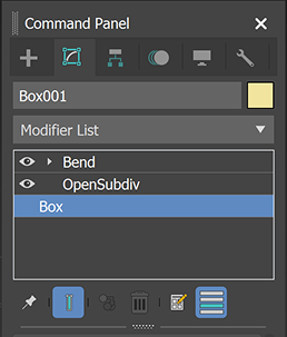

The modifier stack ("stack" for short) contains the accumulated history of an object, including its creation parameters and the modifiers applied to it. If a modifier or object has sub-objects, such as Vertex and Edge with editable poly objects, you can access these directly within the stack.
Upper part of Modify panel, with modifier stack (white outline)

When you first apply a modifier to an object, the modifier is enabled by default. When a modifier is enabled, its light-bulb icon in the stack is white, as depicted in the preceding illustration.

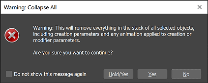

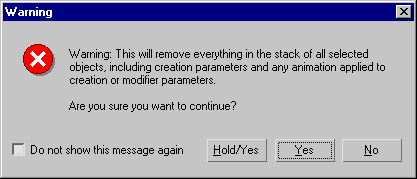

Convert a selected modified object to an editable object:
- Right-click the modifier stack, and choose Collapse All.
A dialog opens, warning you that the collapse operation cannot be undone, and gives you the option of performing a Hold before converting the object.
Note: The result of Collapse All depends on the contents of the stack. For example, if the object is a primitive modified by non-format-specific modifiers such as Bend and Twist, the result is an editable mesh. If the uppermost modifier is of a specific format, such as Poly Select, then the result is an object of the same type: in this case, editable poly. If the object is an editable poly and its modifiers don't change the format, the result is an editable poly. - Right-click the object in a viewport, and choose Convert To
