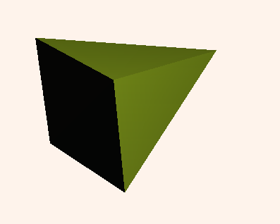

Delegate Helpers
The Crowd system in character studio uses Delegate helper objects as intermediaries between the crowd simulation and the influenced objects. A delegate is a non-rendering pyramid-shaped object. Its apex points in the direction the Crowd system uses as “forward” when it moves the delegate around.
Use one delegate per object to be animated by the Crowd system. You can add delegates one by one, or use any of the standard 3ds Max methods for cloning objects, including Shift+clone and the Array function. However, the Crowd object offers a convenient Scatter Objects function that lets you clone delegates and distribute the clones over a surface or within a volume, with options for orientation and scaling.
