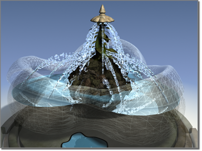

Fountain spray created as a particle system
