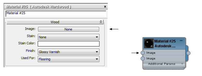

Material components correspond to “slots” in the Slate Material Editor’s display of material nodes.
The mappable Base Hardwood component (on the left) appears as a Base Hardwood slot in the material node (on the right).
