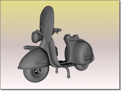

Scooter rendered with the default standard material
